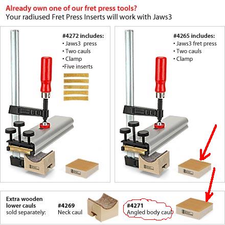

Hesh, i think that the yellow thing is the curved brass insert to help press the fret in, nice tool!

Hesh,
I think the way it works is that the black thing with the 3 screws and round knobs holds the radius'd inserts, the "flat yellow thing". It looks like this rig is attached to the end of the big metal caul that's clamped to the neck/fb. It's basically a screw clamp with a radiused fret caul insert attached to the end of a metal beam. Looks like it's designed for the 3 or 4 fret slots at the heel and neck block.

Probably a unique design of fret press caul that is also made of brass and into which the fret press inserts are put under Hesh, that's what it looks like from here but i could be wrong i think it happened to me in 1977!
PostPosted: Wed Jan 03, 2007 2:58 pm
The angled body caul? For solid body guitars.

PostPosted: Wed Jan 03, 2007 4:00 pm
Hesh
you mean this extra yellow piece?
I think Chris said it already, you may have missed it in his post.
I would think that is for pressing the frets overtop of the neck block, where the back is angled use this caul on the bottom of the clamp.

My guess is that it is an angled caul with a yellow rubber cushion for putting against the heel cap of the neck on the under side....
ooop`s didnt see that that Rod already got it....sorry
cool tool, especially in repair situations.

[QUOTE=JJ Donohue] What's wrong with pressing in all the frets before gluing the FB to the neck?[/QUOTE]
JJ, I think if you're building a guitar that works great as you say, but when doing a fret replacement job, you don't really want to remove the FB from the neck... so this is a tool used for repair work moreso than for building.
